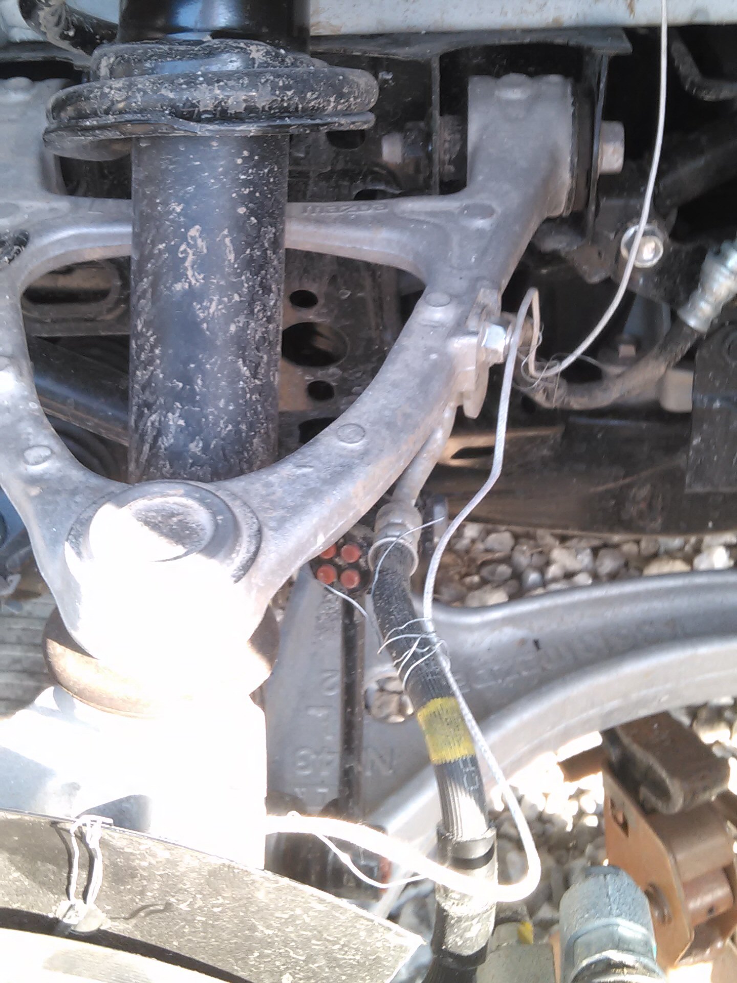

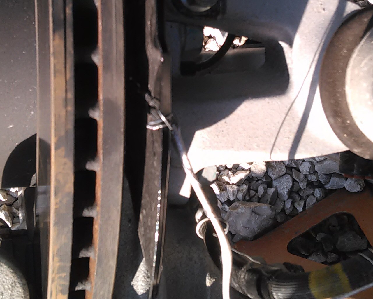

I did some thermal testing on a new idea I've been working on, and I am amazed (though I shouldn't be) at how little the front brakes cooled between instances of braking. Using a cheap thermometer with dual inputs and a pair of thermocouples, I placed the probes between the brake disc and dust shield (at the top, where there's a little hole in the dust shield where I was able to wire-tie the probe end), with an experimental vent on the left, and stock setup on the right. The brakes are totally stock, and just under 2,000 miles old.
I had my son behind the wheel, and me with the thermometer, doing some datalogging and shooting some (very poor) cell phone video. Even with just a quick 60 - 30 firm brake, then back up to 60, the non-vented side just got hot and stayed there for a while, in addition to getting hotter than the vented side. In an autocross, this would be totally unacceptable. It makes sense, though, why the brakes get so hot so quick and don't cool off. I've noticed brakes are getting bigger and bigger from the factory. It's not just weight, it's aerodynamics! Those aero shields they put all up underneath just don't allow NEW air to get into the wheel wells! The only air that can get in is probably coming from what gaps there are in the splash shield and engine bay, which means the air has already been pre-heated by the engine.
...the non-vented side just got hot and stayed there for a while, in addition to getting hotter than the vented side. In an autocross, this would be totally unacceptable. It makes sense, though, why the brakes get so hot so quick and don't cool off.

Your lightweight calipers front and rear are very near the top of my shopping list! This experiment with the vent kit was to prove/disprove whether or not I'd want to go BIGGER with calipers and rotors, or stay stock size and go for the weight reduction.
I'd say the experiment was a success. That means the lightweight brakes from Good-Win, decide on the coilovers, get final measurements, and then get some 15x10 wheels and slicks :D
I didn't have very high temp probes, so I couldn't measure caliper temps directly, and I didn't do anything really extreme, since we were on public roadways. So I don't have much in the way of numbers, except for some raw video I shot while datalogging. What I ahve so far, with the probe mounted between the rotor and dust shield (basically measuring the heat radiating off the rotor)
Driving 60mph, and firm braking to 30, there was a 10*F difference between vented and non-vented. Not only that, but the non-vented side stayed +5 for more than a minute, so even when not braking, there just wasn't much airflow for recovery. To simulate gonig down a long hill, I had my driver ride the brakes at 35mph, and the difference quickly shot to 25*F in a matter of seconds. Recovery again was much better on the vented side. I know I've seen cars with vents built into the front of the wheel well splash shield (mostly high-end) and the idea actually came from my old race car. When Chrysler engineers developed the Neon ACR, they intentionally included the fascia with fog light holes, but no fog lights, making brake venting very easily added.
As soon as I've cleaned it up and finished the other side, I'll post up this new mod on the Project Mamba build page in the Builds forum.
