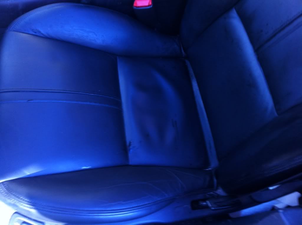

Anyway, a very dirty seat will look like this.
(First off I apologize for the ****ty Iphone pics)
(I bought the car used with seats looking like this if you're wondering)
Note its shiny appearance; thats exactly what you dont want. That means the seat is covered in dirt & grease. A seat should never look like this unless you put interior shine or whatever on it.
