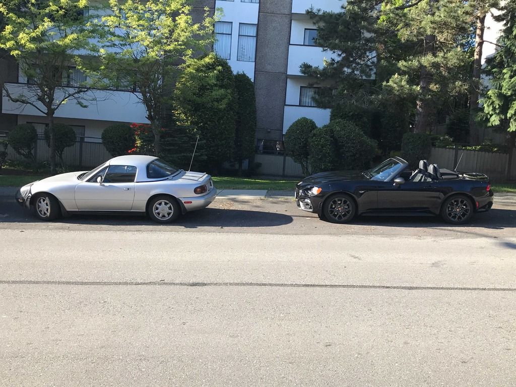

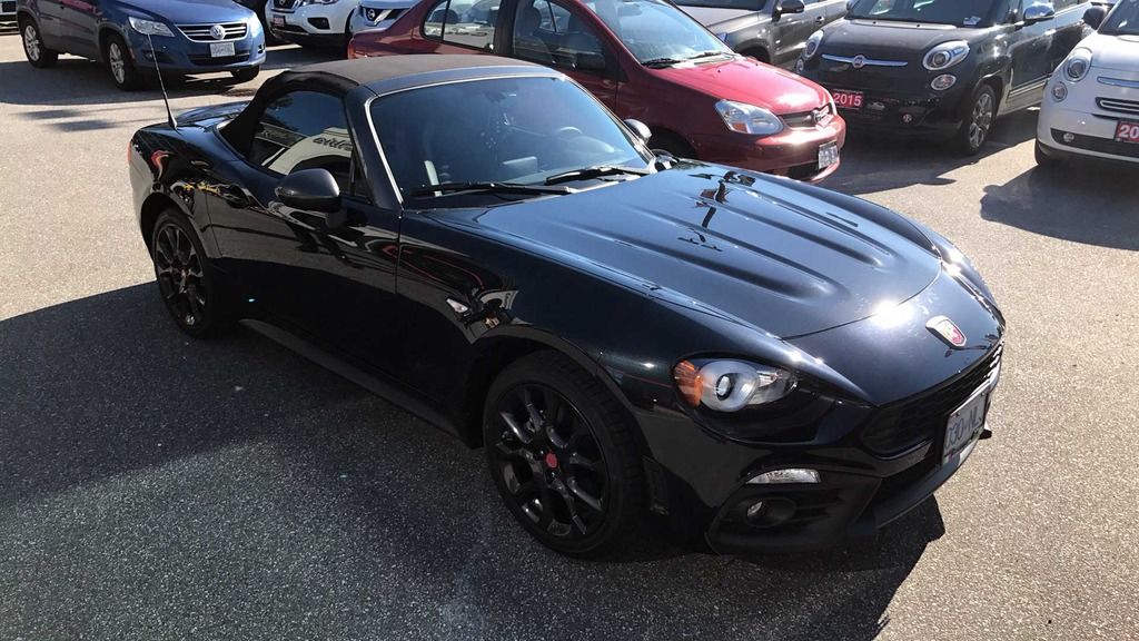

I joined a while back but just picked up my Abarth 124. I've had it for 3 days and I've racked up 300 miles of mountain driving already. I can't get enough of this little thing. I traded my 500 Sport Turbo in after driving the Abarth version. It was just a no brainer.

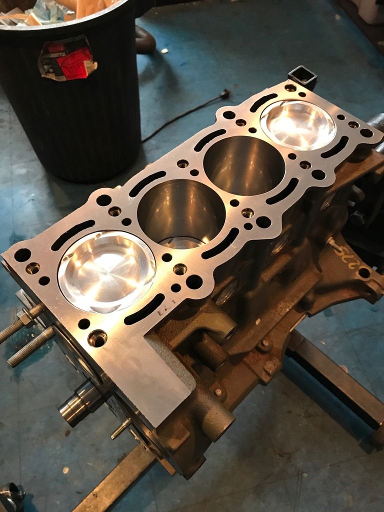

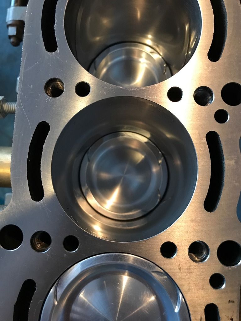

The catalyst to this decision was my new engine. I have a new built 1.4 MultiAir Turbo that was destined for the 500 but will now be going into the 124. I felt a 400 horsepower engine would be a bad match for the 500.

Holy ****!
Reactions: Redtoys and Dennis
3,113 Posts
I second that! I'm really speechless
I thought the 1.4 could take 300HP, now 400HP will the axle and transmission able to take all that power and torque. This is torture. >:):eek::nerd:
4,058 Posts
My Charger is 470 hp, and weighs more than a ton more than the 124. 400 hp in the 124 is obscene LOL.
But seriously, keep us posted, this is crazy awesome.
400 only because it's a built bottom end and the head is ported to flow. I'm extremely sceptical of any 300 horsepower claims out of the stock engine. People talk a lot but there's no proof.
I'll strengthen whatever is necessary to get there.
