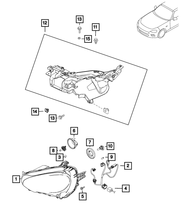

Folks, would anyone be kind enough to tell me if the headlamp connector referred to here, #4 in this diagram (AKA part no. 68313071AA) is the same for LED and the halogen projector headlamps for a 2017-2020 Spider, or are they different connectors? And might anyone have a pic of what that plug end looks like? Thanks in advance.

If I’m looking at this correct, #4 is the main under hood body harness. Is this what you are referring to? Or the headlamp harness that shows as #2 and is the jumble of wires behind the sketch of the headlamp housing. If it’s #4 likely they are the same if #2, it is highly unlikely they are the same because of the extra features the led package adds. The connectors however may be the same, save for some missing wires and pins. I know this wasn’t much help but it’s the best I got.

Discussion Starter · #4 ·
Thanks, that is helpful. It is indeed #4 I am looking at. I think #4 is a connector that has 5 pins across, 3 pins down, and a gap in the middle shaped like an H, but, I am not sure.

Yes, these refer to the three wires of the harness #2, that connect to the main connector, #4 in the diagram reproduced here:
