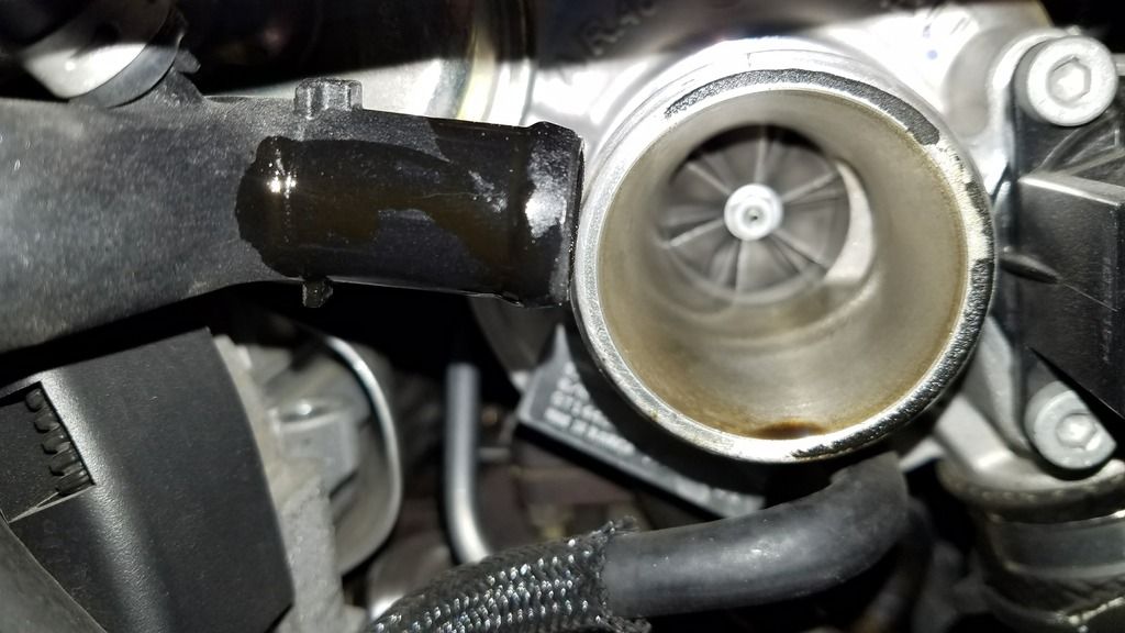

It's totally normal. I don't like it, but these engines throw a lot of oil into the intake system when they are on boost. A good catch if configured properly will reduce this significantly.
1,442 Posts
It appears by this photo that you have damaged the leading edges of your compressor wheel. Have you been running the engine without a filter?
When I first read this and thought "oh noes, hyper critical turbo guy ragging on someone's turbo" [please take this in the jocular manner it was intended], then looked at the picture and....woa! That does seem beaten up...
If it helps, I'm an automotive engineer that designs turbos so I've seen a lot of compressor wheels. In fact, I just posted photos yesterday showing a new upgraded billet compressor wheel/turbo I'm working on.
1,442 Posts
That's what I guessed, just giving you a hard time :)
You know what they say about brain surgery: not exactly rocket science, is it? :p
4,134 Posts
Those blades do look beat up.

That was my other concern, past the oil. Might put the stock intake back on and head to the dealer. Absolutely haven't run without a filter.

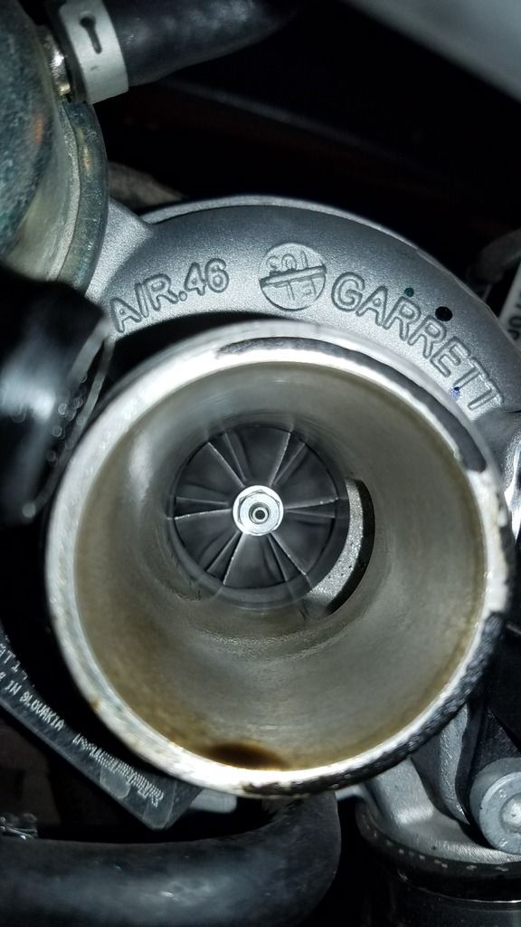

Thank you, guys. Took the car into the dealer and they let me know a couple days back that they're getting a new turbo put in under warranty. No idea what could've caused this, or if it came like this from the factory. Here's a better picture I got:
4,134 Posts
Glad they are fixing it for you.
