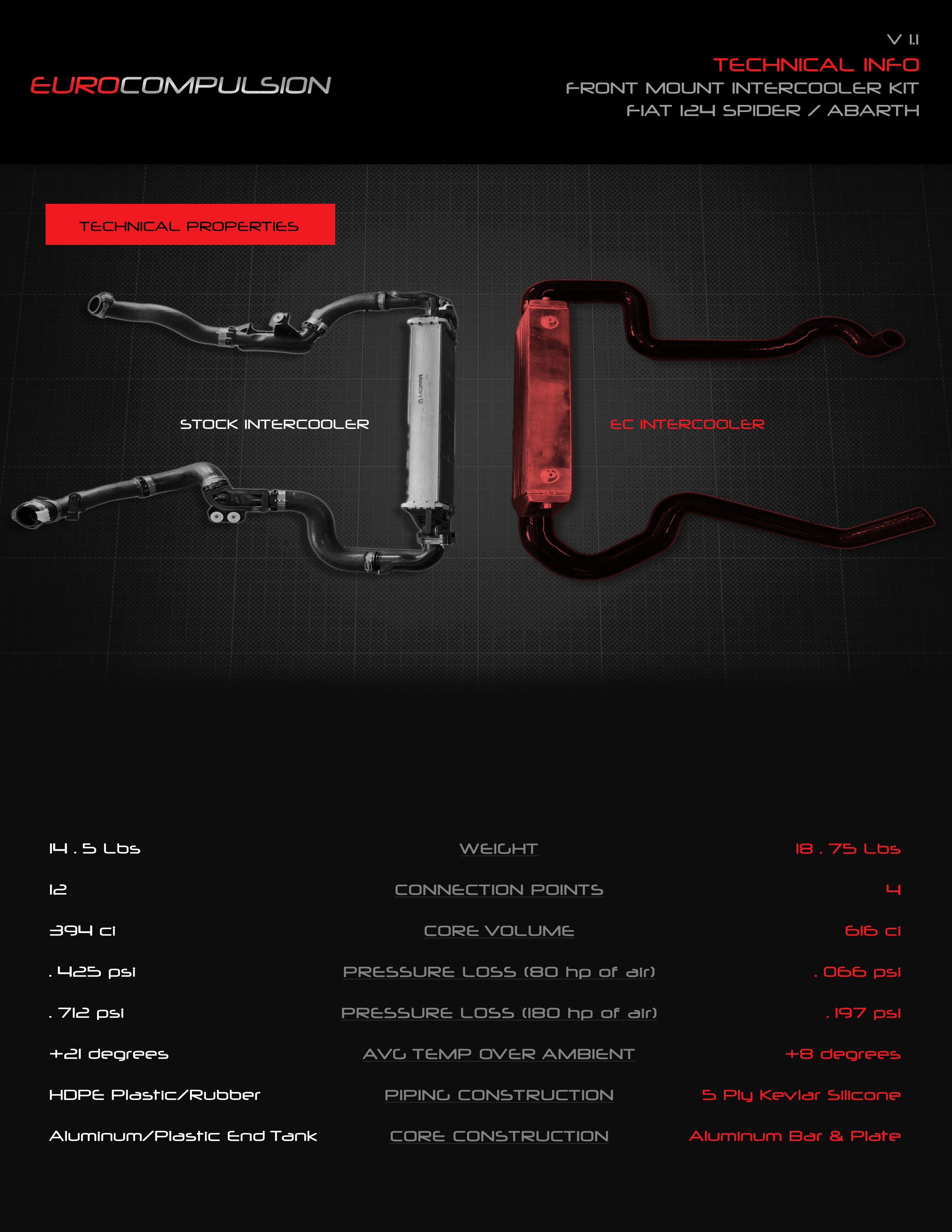

The EUROCOMPULSION FRONT MOUNT INTER-COOLER KIT for the Fiat 124 Spider and 124 Abarth features heavy duty 5 ply silicone with 4 layers of our KEVTEK reinforcement. These heavy duty pieces are built to withstand pressures of 80+Psi and temperatures of 600+ degrees.
Our Silicone piping runs a single uninterrupted line from the turbo to the inter-cooler and a single uninterrupted line from the inter-cooler to the throttle, reducing possible leak points/connection points from 12 down to 4. Our Inter-cooler core features a bar & plate construction and 616ci core volume, 56% larger than the factory system's 394 ci core volume.
Combined together, our kit will effectively lower intercooler temperatures, increase turbo efficiency and longevity, while helping sustain engine power and efficiency (especially when paired with other power oriented modifications). This kit features brackets for easy mounting and requires ZERO drilling or modifications to your vehicle, maintaining factory-like fitment.
FULL INTER-COOLER KIT FEATURES:
  • Bar and Plate Inter-cooler
  • 56% increase in cooling capacity over factory system (394 to 616ci)
  • Reduced and simplified Hose routing
  • Larger Diameter Piping and End tanks for Higher Flow Capacity
    • Stock IC Diameter at Inlets and Beyond: 1.5 inch
    • EC IC Diameter at Inlets and Beyond: 2.50 inch, reduces to 2.00 inch to turbo
  • (4) Connection points VS (12) Factory Connection Points
  • Zero Drilling or Modification for Installation
  • Factory Fitment
  • Replaces ENTIRE inter-cooler system, no stock hoses used!
  • Reduced Pressure drop/Increase in Cooling efficiency
  • Minimize and eliminate boost leaks/vacuum issues
  • 5ply, KEVTEK Reinforced Silicone
  • Kit Includes Silicone Hoses, Mounting Brackets, Clamps and Inter-cooler Core
APPLICATION:
FIAT 124 Spider / 124 Abarth (Worldwide)
Auto Trans: Confirmed Fitment
Manual Trans: Fitment pending
TECHNICAL INFORMATION / TESTING DATA: HERE
KEVTEK INFORMATION: HERE
PURCHASE INFO:
HERE
PRICING: $799 + Shipping

I have a somewhat technical question about this. I understand the numbers, but at the end of the day, what benefits does it give while driving? The reason I say this is because it mentions 'heat soak'; it was a warm day, yesterday, and slowly moving through traffic and lights, it seemed like there wasn't much power, and felt lumpy, through the ref range until I got going after a handful of seconds. Is there any causation here?
549 Posts
And I have another technical question.
As a Mechanical Engineer working thermo/fluids (but not in the automotive realm) I really dig the technical aspects and see the potential benefits .........however I have one nagging question.
With the greatly increased volume with the enlarged pipes, actual inter-cooler and technically the "cooler" air surely then when the turbo needs to spool up again then its first period of "work" is to pressurise that greater volume, before the increased pressure is realised at the throttle body .........possibly leading to more lag ???
Am I over thinking this ??
I was never convinced with the benefit of a larger intercooler on the A500 ........ apart from possibly heavy track work with loads of full throttle action. And I have a few acquaintances with fully sik(you say that in the States??) mod monstered EVO's and GTR's with massive intercoolers and the LAAAAAGGGGGG make them undrivable ....IMHO
3,951 Posts
If you go too big, you will have trouble with lag. My guess is that EC sized this right. Their tune will help, too.
Reactions: hefbadr and Greg
3,649 Posts
Great. I love questions.
I wouldn't say you are over thinking it, but it's just not significant in this case. While the stock tubing does choke down below 1.5" id in several sections, it's average is probably around 1.75. Our tubing is generally no less than 2.0" id and goes up to 2.5" near the intercooler inlet and outlet. The average is probably around 2.25. This volume increase just isn't very significant when compared to the total amount of air the turbo needs to move into the engine at full boost. In short, a couple thousand ccs in the piping isn't anything compared with the 150,000+ccs the turbo will need to move in ONE SECOND at higher RPM and boost levels.
I can't detect or measure any decrease in turbo response with the bigger intercooler. If anything, it's better. Of course all testing was done on a tuned engine which obviously moves more air and thus is more adversely effected by the restrictions in the stock plumbing.
I have no experience with EVOs, or GTRs. However I suspect that they have these giant intercoolers because they have giant turbos, and that's probably what's causing most of the lag. Or perhaps they just went way too big on the intercooler and piping. That's not what I am doing.
Regarding the A500, it sounds like you may be in Europe, most of those cars in Europe have smaller turbos and 135hp, in which case the stock intercoolers are fine. However with the 1446 turbo, when you start approaching 200hp, the stock intercooler starts to become marginal.
Clearly the factory guys know what they are doing. So let's look at what they do! On the hottest factory 500 Abarth, which is the 695 Biposto, they put in a larger intercooler and larger piping. Why? Not because I told them to, but because the normal stock intercoolers were not up to the job. The same is true of the factory built 500 Abarth rally cars.
Edit, I see you are in Australia, the same is true of those A500s :)
3,649 Posts
What benefits are there? Good question.
On a stock engine you will get a little more power due to the lower temperatures in normal conditions. However the bigger advantage is that our intercooler is much more resistant to heat soak. The stock system will start to lose power after repeated runs, or when sitting in traffic. Our system will not lose power while the car is moving and will lose far less if sitting in traffic, and will cool down much more quickly once the car is moving.
On modified cars, the benefits are greater as there is more heat to remove, and the larger intercooler is more effective at doing that, and the larger pipes are far less restrictive.
We actually have temperature and pressure loss charts up to show the differences. At full throttle our intercooler runs about 20F cooler, which not only provides more air density, and thus power, it allows more timing, which is important. The reason you feel these cars slow down when they get hot is usually because the temp crossed a threshold that causes the ECU to pull back timing.
P.S. this product is really aimed at people who plan to modify their cars with an intake and a tune. It would probably be very rare for someone to do this upgrade as their one and only mod, although if they did, I still think they would be happy with it, but it's not the intent of the design.

I can answer some of the questions above as well with my personal experience. I've had this intercooler on for just over a week.
The volume increase is significant as a percentage increase over the stock intercooler system. However, the increase is inconsequential as a ratio of airflow to intercooler system volume and is negated many times over by improved airlfow achieved through reduced restriction, larger average diameter, and fewer transition points.
Greg mentioned that for most driving, the stock intercooler is adequate, but I would correlate the comparison to running this engine on 87 octane. Sure, it can do it if you have nothing else available, but it won't run optimally. I used to look forward to the fall season because temperatures drop. Car guys call it "boost season," because the cooled air charge provides a significant increase in power. With this intercooler, it feels like every day is boost season. I find that the power the car now provides, even when driving in 80-95 degree weather, exceeds my expectations. I expect the car to bog down a bit, but it doesn't, and furthermore, it pulls harder up at the high RPM range where previously, it used to flatten out.
As Greg noted, as the car heats up and intake temps rise, the car begins to pull timing. This results in an immediate reduction in power. Sit in stop and go traffic for long enough with the A/C on and you'll notice some hesitation or throttle lag in addition to reduced power as you take off. This intercooler significantly alleviates that problem. We had a warm spell here lately where temps were in the high 80s and low 90s, and I definitely noticed improved hot weather performance.
Overall, performance is far more consistent, heat soak is drastically negated, and the butt dyno is happy.
