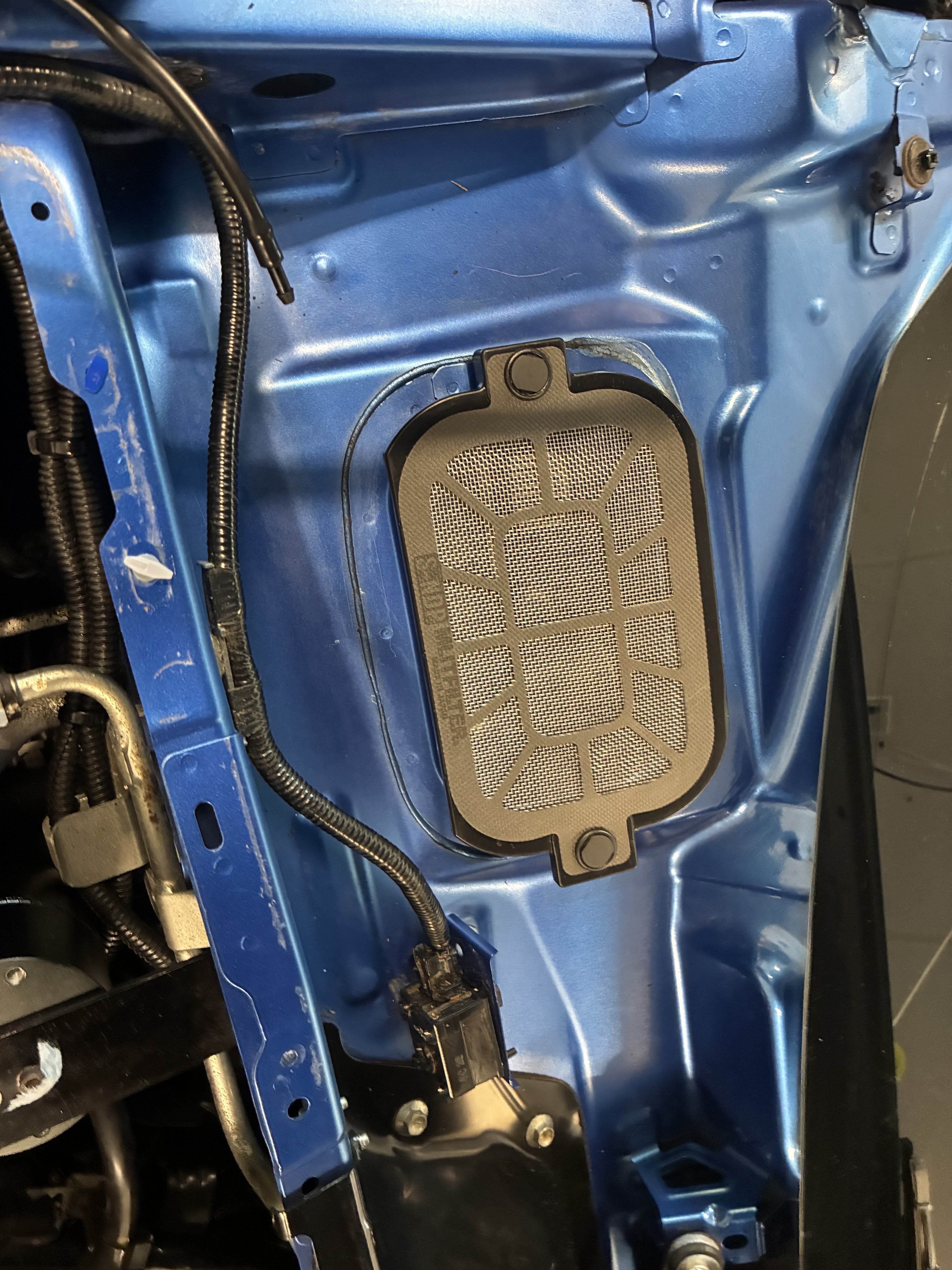

Abs Speed Sensor and installed mesh over the cabin air intake inlet

Installed a mesh over the I cabin air inlet under the plastic cowl passenger side

#3 ·
Abs Speed sensor
Dealer444.00 plus 1.5 hr labor at 160 per hour
Purchased from Mazda Tasca Parts
127.00 out the door
40 min install
If I had to do it again would be approx 20 min. Easy fix.
I’ve not seen that style of filter. Only the ones that are 3d printed with a pleated fabric filter. Do you have a link for that please?
#4 ·
Hi
I purchased it as a set with cabin air filter Amazon (link below) I did see a youtube video which the creator cut metal screen similar to the what you have in a screen door.
Hope this helps!
Brand MLTIFILTER
