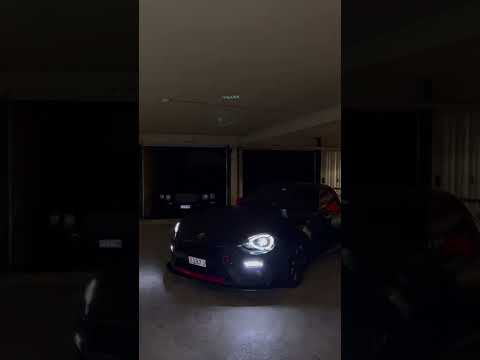

Has anyone since @aless124 attempted this install, and is it literally a plug-n-play swap??
Thanks!
Tizz
Thanks!
Tizz
yes i did it like 2 months ago, one of the best looking mods ive done, it is plug’n play but i had to do some research since i have no idea about this subject. I highly recommend using a piggyback fuse to connect the DRL, it took me like 2 or 3 hours to get the job done (i did not removed the wheels, its not necessary but it would make things easier to do the wiring job)
Oh boy .... I get to learn what a piggy back fuse is..lmao
So, do you have to do the extra wiring as in the video?
They do look damn good though!!
i didnt know what it was when i did it, and trust me, translating piggyback fuse into spanish was PITA, there is another post from other user in the forum explaining details of the installation, its called like “ijdm lights”, good luck.
and no,i did not need any extra wiring
Thanks!! I will look for the post.
I too have bought these the only part that is not plug and play is if you want it to go from white solid to amber flasher. @12S4vage_ was the one who turned me on to these, and a pic of these on a white Abarth with the 300 kit sealed the deal. Btw got mine on eBay under Mazda 3 switchback turn signals, quite a bit cheaper than what was listed for the 124. Same bit.

The other sequential/DRL turn signal mod discussed can be appreciated here:
The sequential taillight dreams stalled with Sergiy @ssh16 3 years ago. Wonder if he'd entertain such thing today?
I think that experimentation ended when he didn't find a willing donor for a set of Spider taillights. Given he was a Mazda owner, he didn't have ready access to Spider components if they differed from those installed on the Miatas.
